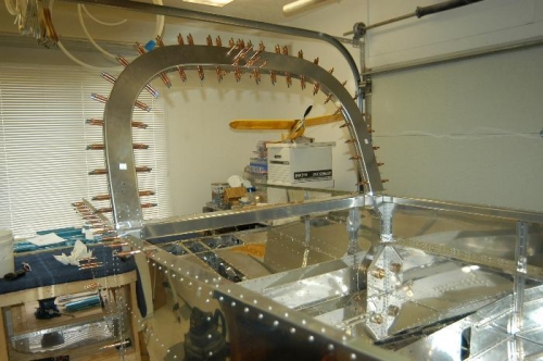

Deburred edges and shaped roll bar straps.
Clecoed roll bar assembly and final-drilled all holes (Steps 1-2, page 24-02). Deburred all holes.
Countersunk outer roll bar flange holes as per Step 3, page 24-02.
Prepped and primed inside surfaces of roll bar.
Separated and deburred F-1254 and F-1232.
