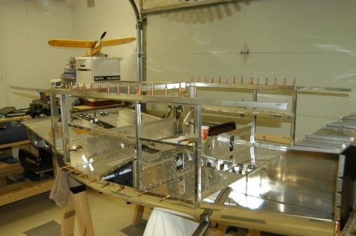

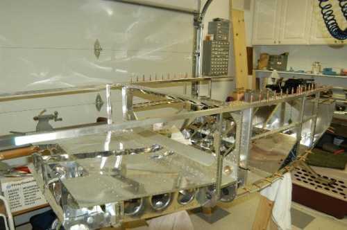

Longerons and roll bar attach plates
Match-drillled left canopy deck to left longeron.
Deburred holes in both right and left longeron and canopy decks.
Prepared and installed roll bar attach plates and mid fuse braces (F-1205A and F-1205C) as per Steps 1-4, page 23-03.
Prepared mid fuselage skeleton for installation of fuselage side skins by completing Steps 1-8, page 23-04.
