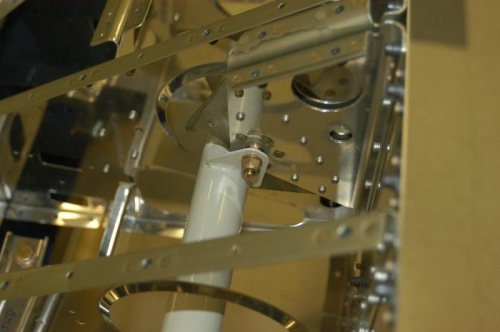

Primed mating flanges of seat ramp floors and F-1202F bulkhead.
Riveted seat ramp floors in place as per Steps 6&7, page 21-13.
Prepped and installed control column as per Steps 8&9, page 21-13 and Step 1, page 21-14.
Installed step ribs and F-1202F bulkhead as per Steps 2-6, page 21-14.
Installed snap bushings as per Step 7, page 21-14.
Separated and deburred fuselage corner skins and F-1268 doublers as per Steps 1 and 9, page 21-15.
Separated F-1204Z bottom stiffeners.
