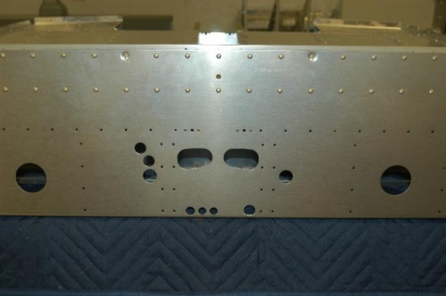

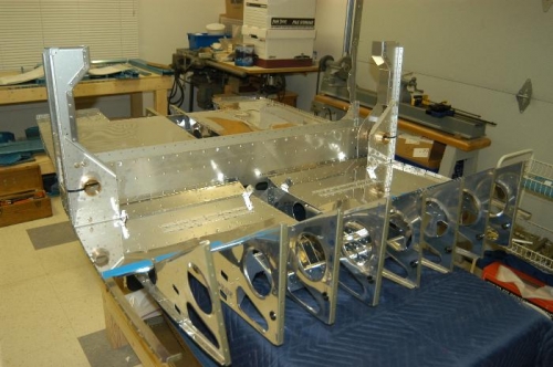

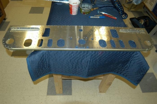

Center section F-1204A in my kit was missing a hold and had one undersized as reported by other early fuselage builders on VAF.com. As per instructions and pictures sent by Gus at Vans, drilled additional 7/16" hole and enlarged the larger existing hole to 3/4".
Riveted seat floor assemblies to center section bulkhead as per Step 5, page 21-08.
Riveted forward bulkhead side assemblies as per Step 1, page 21-09.
Deburred and primed bulkhead caps and riveted in place as per Steps 2&4, page 21-09.
Installed F-1204M roller assemblies as per Steps 3&5, page 21-09.
Assembled control column mount assemblies as per Steps 2&3, page 21-10.
Began assembly of F-1203A bulkhead by completing Steps 8&10, page 21-10 and Steps 2&3, page 21-11.
