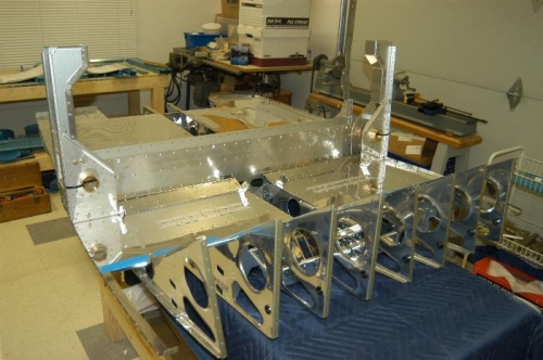

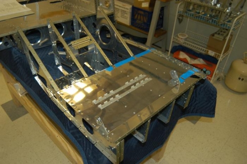

Date:  12-20-2008
Number of Hours:  9.00
Manual Reference:  21-03, -06 to -10
Brief Description:  Seat Floors
Installed remaining baggage ribs, baggage floors, and bearing bracket assemblies as per Steps 3-8, page 21-03.
Assembled crotch strap brackets and installed to seat rib assemblies as per Steps 1-6, page 21-06.
Deburred seat floors, separated and deburred seat floor supports and primed mating flanges.
Cut, match-drilled, and installed seat back hinges as per Steps 7&8, page 21-06 and Steps 1&2, page 21-07. One slipped during drilling and had to be remade. Will see if enough hinge remains for later steps.
Prepared and installed seat floors and supports as per Steps 3-9, page 21-07 and Steps 1-4, page 21-08.
Deburred, countersunk, and final-drilled F-1203A bulkhead as per Steps 6&7, page 21-10.
