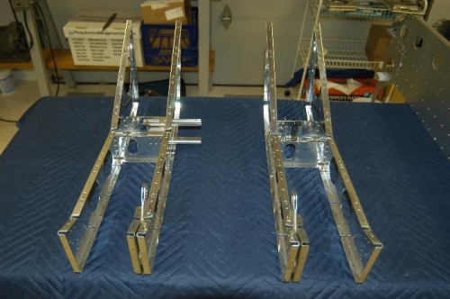

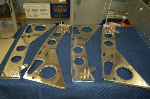

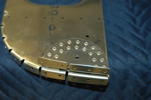

Date:  12-14-2008
Number of Hours:  7.00
Manual Reference:  21-02, 04, 05
Brief Description:  Bulkhead Assebly and Seat Rib Assemblies
