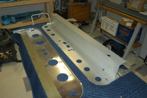

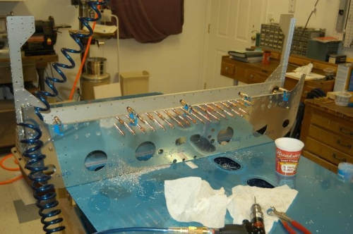

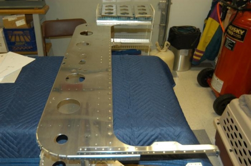

Brief Description:  Fuselage Center Section Assembly
Aligned and match-drilled F-1204D to F-1204 as per Steps 1-3, page 20-03. Deburred and countersunk called out holes. Primed mating surface of F-1204D. Riveted F1204D tp F-1204, including aft side bulkheads and skin stiffeners. Completed Section 20. Began deburring of parts called out on page 21-02. Assembled bearing bracket assemblies as per Step 14, page 21-02. Borrowed Mike's rivet gun and ordered double offset rivet set to rivet baggage floors in place, as squeezer will be too difficult to utilize due to closeness of flange holes to bend and angle of the bend.
