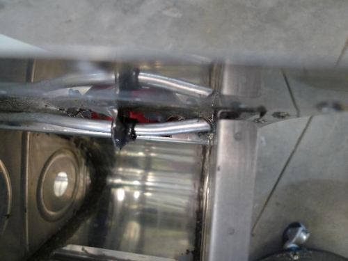

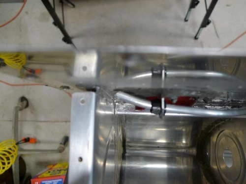

Brief Description:  Step 2 - 3; Fuel tank vent line
Fabricate vent lines both tanks.
Install hours in tank assembly hours.
Intall pics > vent line ends bent upward at cap end to keep tube end as far above fuel level as possible to prevent siphoning fuel overboard with full tanks.
