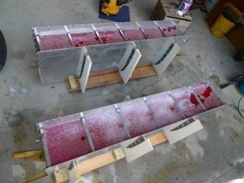

Steps1 - 2: Leak test tanks
Install strainers and hardware plugs.
Build water test cradles- 3 hours. Water test.
Prime exterior of rear baffles after water testing - 1 hour.
Pressure test w/ balloons - install hardware and tweek connections for leaks.
