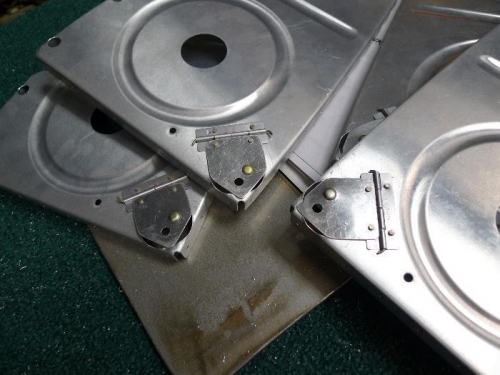

Date:  12-16-2015
Number of Hours:  3.25
Manual Reference:  18-01
Brief Description:  Fuel tank baffle rib fuel slip gates.
Owner option; design, fabricate, assemble, and attach to two each tank on #2 and #3 inboard fuel tak ribs - fuel slip gate to restrict large outboard flow of fuel from inboard portion of fuel tanks.
REVISION: Installed only on rib #3 as on #2 interferred with fuel sender float.
