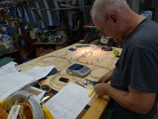

Brief Description:  Common Fuselage Wiring Harness
Built wiring board, determined all wiring sizes and runs, determined connectors, ordered three or four (more) times, cut lengths and installed wire runs on wiring board, labeled individual wires, installed Molex and other connectors, installed harness into fuselage. Took a couple of months.
