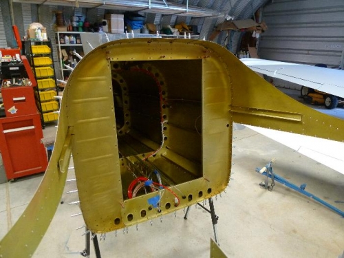

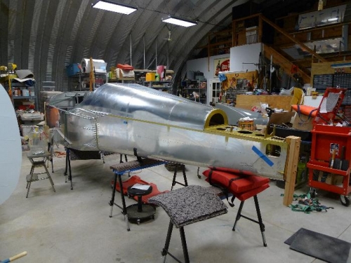

Brief Description:  Attach Aft Fuselage
FInished Section 30 - 11/13/16.
Prepped for attaching fuselage sections and installed myself, coonecting took about 3 hours from start to total clecoed connection of the two halves.
Used four saw horses and rolling cart for maneuvering and alignment of halves.
Made soft alum 3030 "shoe-horns" to allow insertion of rear fuselage cone into cabin fuselage seaction at join interface.Also used gorilla tape to help holding.
