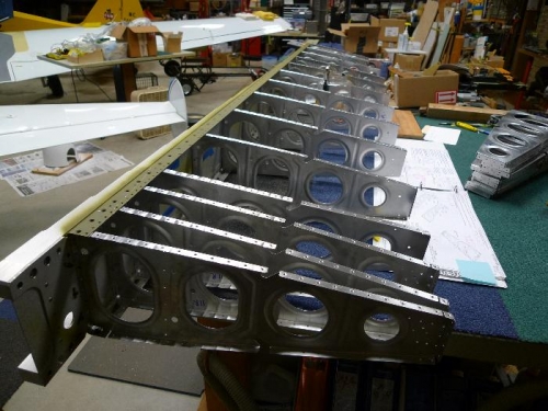

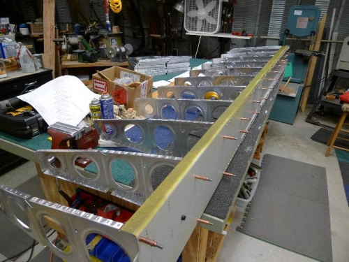

Step 3; All wing rib prep
Deburring flange and lightening cutouts, flange 90 degree bend, drilling, fluting, scuffing; all main wing ribs. (8/29 to 9/18/2015)
