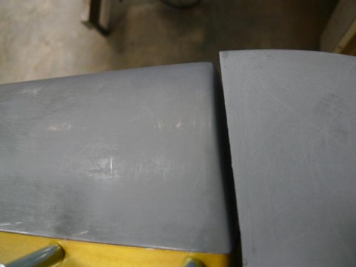

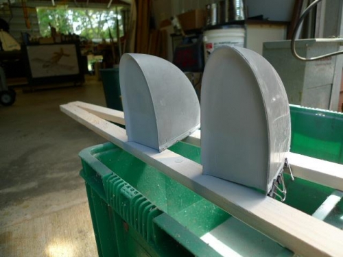

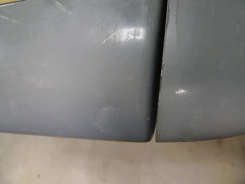

Brief Description:  Horiz stab tip fairings
Found that the horiz stab tip fairings extended further out than the elevator fairing at their alignment point. Adjusted the HS fairings by buiding up the fiberglass inside the HS fairings in order to create a new flange break approx 1/4" farther in in order to get the HS and the Elev fairing to alighn at their outer ends.
On the HS and rudder tip firings I inset the fill buid ups approx 1/4" instead of making them flush with the trailing edges of the fairings in order to allow for trimming edges in case of needed adjustments; also I like the fit and finish on the recessed fill build ups.
