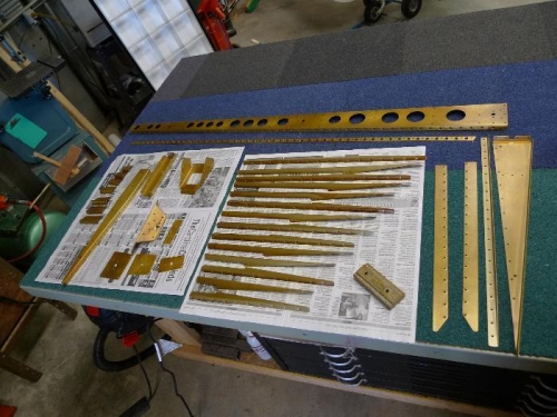

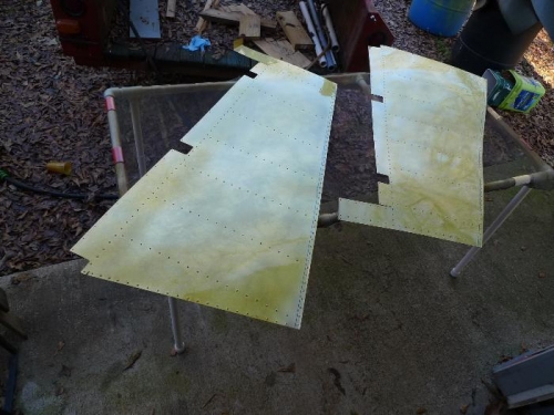

Prime rudder parts
Cleaned w/ acetone, primed PPG etching primer (Spectracron QAP701/QAP702; 1:1.5 mix). Ready to assemble.
Rudder parts
Rudder skins
