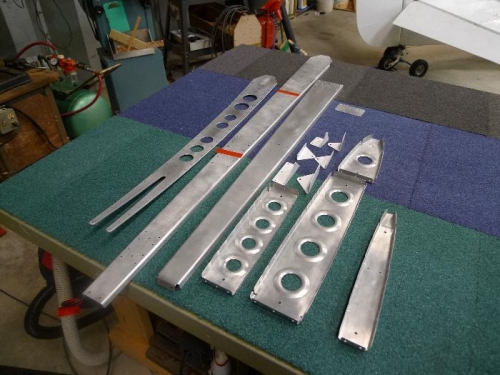

Vertical Stabilizer
Since 11/23, prep VS parts; scoth-brite ribs and spar parts, flanges fluted and dimpled, skin clecoed to assembled VS sub-structure and match drilled and reamed rivet holes for fit.
Plus, more shop arrangement, and floor and bench tool prep.
