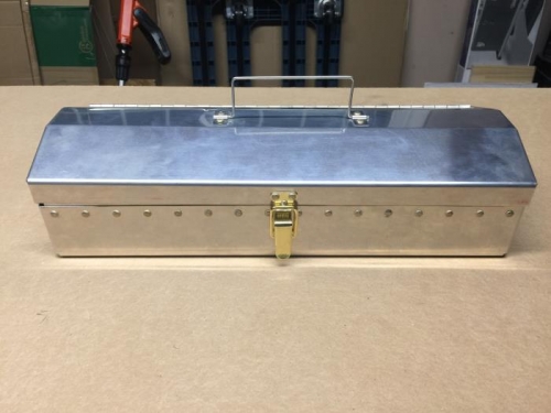

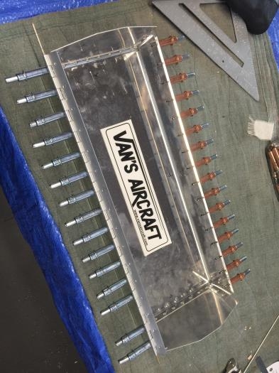

Finally got to complete the Toolbox practice project after a long time away from an elbow surgery and traveling for work. Here goes:
Tasks completed:
1. Final Cleco
2. Match drill all holes not previously matched
3. Cut hinge, drill, and debur
4. Final riveting.
Lesson Learned:
1. Really need to keep a good amount of pressure between the rivet gun and the material. Especially with those round head rivets. Too easy to bounce and mess up the rivet or material.
