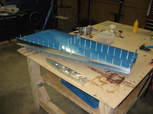

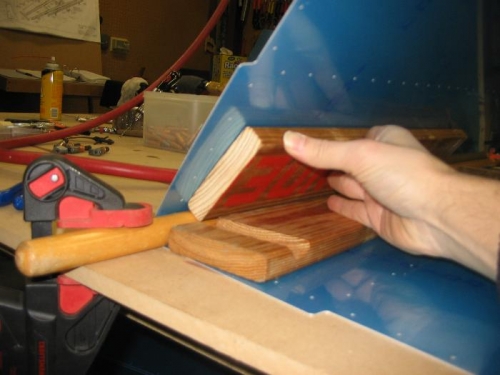

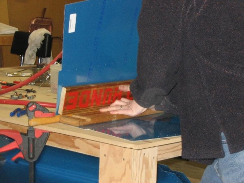

Started initial assembly of the RH horizontal stabilizer. Since I didn't take any pictures of how I had to unbend the LH HS skin, I took some of when I did it to the RH one. Nothing fancy, but it worked. I clecoed the skin to the RH horizontal stabilizer and fluted the inboard ribs so that I could clamp them in place and match drill the rivet holes into them. This half went together much quicker than the left one did. That's all the farther I got. Had to go inside and kiss my daughter good night.
Here's My Goofy Unbending Setup
Me Unbending the RH HS Skin
Skin Clecoed to the RH HS and Inboard Ribs Ready to Install & Rivet
