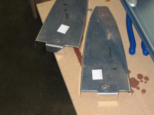

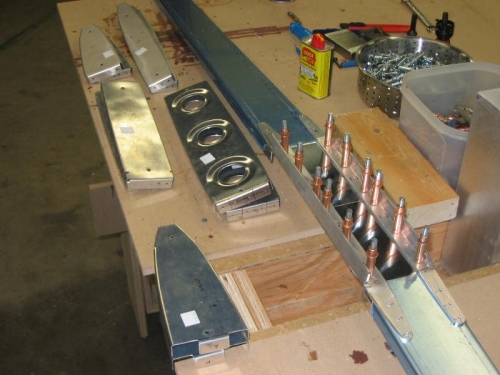

Trimmed the excess flange from the HS-404 ribs to clear the front spar angle during assembly. Tweaked all of the rib flanges to make them perpendicular to the rib webs and fluted each to make sure they were straight. Also located and drilled the holes in the HS-405 rib for future match drilling during assembly.
Inboard Forward Ribs Notched to Clear Spar Angles
All of the Ribs Fluted and Prep'ed
