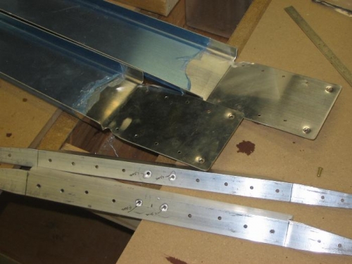

Brief Description:  Spar Angle Center Holes and Angle Double Check
Dimpled the inboard-most holes on the front spar and c'sunk the matching holes in the spar angles. Took me about ten minutes of brain bending to make sure I had the dimples and c'sinks on the correct side of the parts. I think they're correct. Just to make sure, I decided to assemble the front spar as best as I could for now and double check the spar angle bends. They look pretty good.
Dimpled and Countersunk to Accommodate Flat Head Rivet

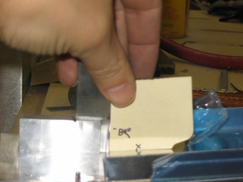

Double Check of Angle Bend (RH)

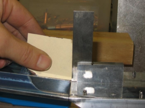

Doulbe Check of Angle Bend (LH)
