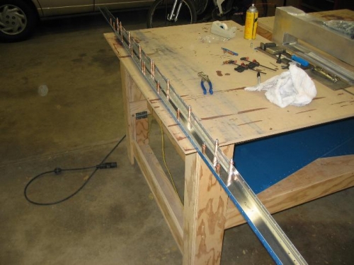

Brief Description:  Drilled out Holes on Rear Spar Stiffeners
Fit the HS-609PP rear spar stiffeners to the HS-603PP rear spar halves and clecoed. Drilled out all of the holes to #30. Didn't have the #19 drill to drill out the holes to for the mid span rib blind rivets that will be used later. Good stopping point for the night. Need to spend some time with my daugther Alex before bed-time.
Stiffeners Fit to Rear Spar
Stiffeners Clecoed and Drilled to #30
