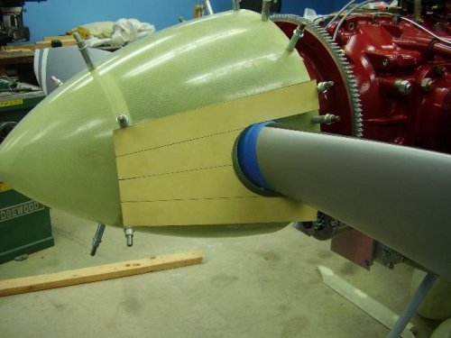

Number of Hours:  3.00
Manual Reference:  ?
Brief Description:  Spinner fillin plates added
Nearly finished with the spinner attachments. Reworked the cutouts from behind the prop. Drilled holes for rivets and clecoed them up. I'm leaving about .100" clearance around the prop including clearance for all prop travel. Need to make the attachment plates between the main spinner section and these fill in sections.
Cutout plates fitted
