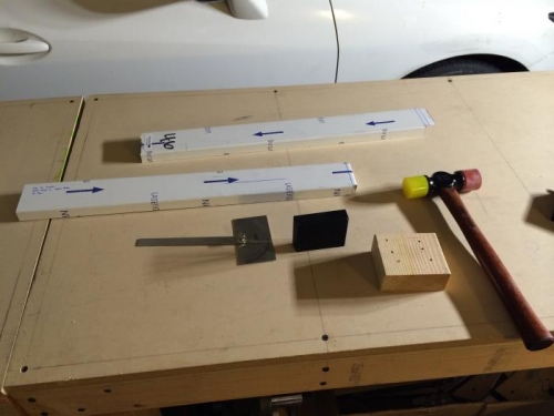

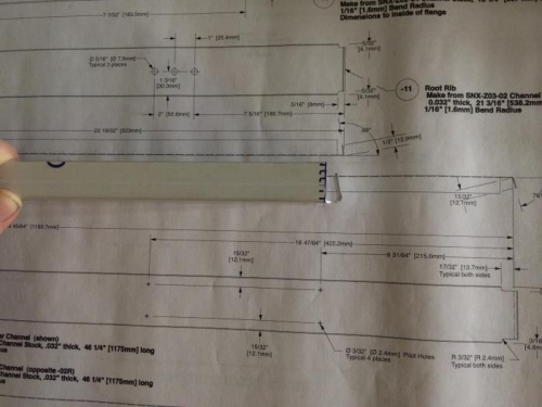

Used the forming blocks to bend 99 degree angle with 1/16 in bend radius into Root Rib XNS-T06-11 using rubber mallet. I did this for both root ribs.
I deburred edges of the root ribs. I did not like the edge debur tool that I bought from Amazon ... so I started using the VX10 vixen file instead.
