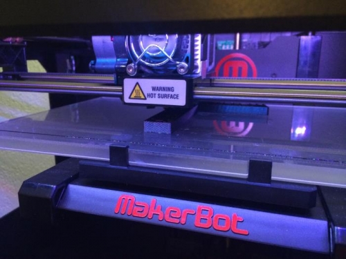

Brief Description:  Tail - Created Forming Blocks for XNS-T06 Channel
Designed and 3D printed forming blocks at 99 degree and 76 degree angles with 1/16 in bend radius to form the XNS-T06-02, -11, and -12 through -16 channels into the spars and ribs that require 99 or 76 degree bends.
