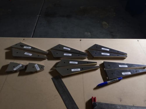

I marked the following piecews with a line 1/4 inch all the way around the flange:
XNS-T04-06 x 2
XNS-T04-07 x 2
XNS-T08-03 x 3
XNS-T08-04 x 3
XNS-T08-06 x 1
XNS-T08-07 x 1

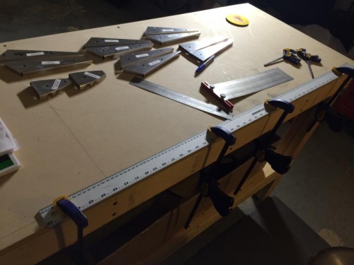

To do this easily, I clamped a straight edge to my workbench with a 1/4 inch overhange to consistently get a line on each part.

Tool for measuring 1/4 inch up flanges of rib parts
Marked ribs
