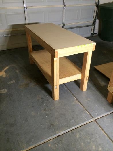

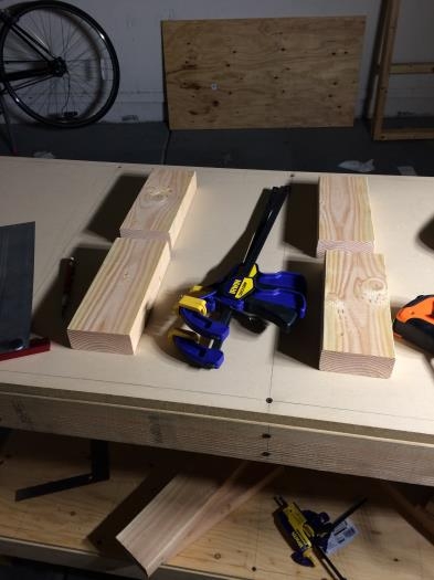

I completed the eight short leg doublers. The plans call for an approx 8.5 inch 2x4 for the bottom leg doublers, but note that it will need to be measured and cut to size. I need 8 and 3/8 inch pieces of 2x4 for my tables.
I used a circular saw with speed square to cut eight 8 and 3/8 inch pieces of 2x4. I then glued and screwed these pieces to the bottom portions of the legs.
Second table with leg doublers installed.
First table with leg doublers cut and ready to be installed.
Both tables with leg doublers installed.
