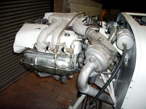

Fuel Rail
I manufactured 4 sleeves on the lathe to fit over each injector. I machined steel T-pieces and silver soldered them to the sleeves. I then used 8mm steel brake pipe with compression fittings to make up the fuel rail.
Fuel Rail
Injector Sleeve
