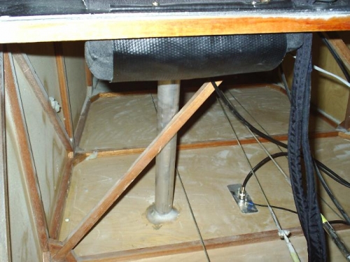

Brief Description:  Ballistic Parachute
I made an opening through the bottom of the fuselage and throught the bottom of the baggage area with a 50mm hole saw. I then routed a 50mm aluminium pipe through both openings and used cotton flox to secure it. This pipe will serve as the exhaust pipe for the rocket.
