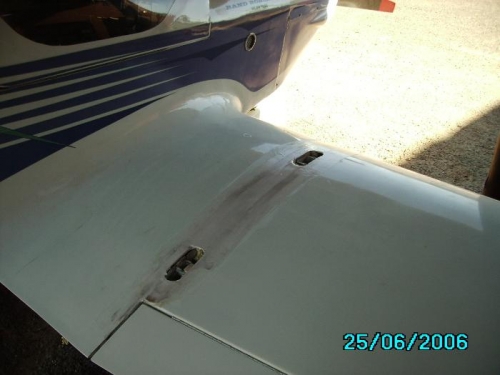

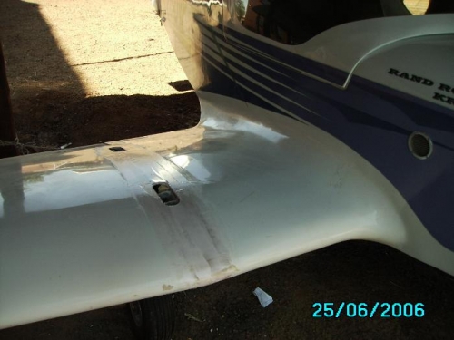

Brief Description:  Join Wings And Stub Wings
After filling the gap with cotton flox, I covered gap with 3 layers of fibreglass. I covered the fibreglass with peel ply which I removed when it was almost dry. After curing, I used a hole saw and a dremil tool to make the access holes to the wing attach fittings.
