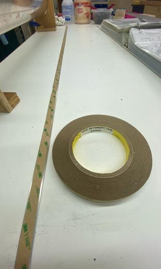

Brief Description:  Attached the Left Trailing Edge to the Aileron Ski
Attached the Left Trailing Edge to the Aileron Skins. Strips of 3M Very High Bond (VHB) Tape was applied to both sides of the Trailing Edge extrusion. After a short time to allow bonding, the Trailing Edge was clecoed into pace between the skins.
Clecoed the Aluminum Angle to the Aft Edge of the Aileron to keep the aft edge straight during the bonding of the VHB Tape to the Skins and Trailing Edge extrusion.
