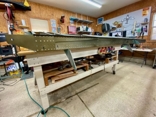

Completed Right Rear Spar Assembly
Completed Right Rear Spar Assembly.
Riveted the Rear Spar to the right wing ribs.

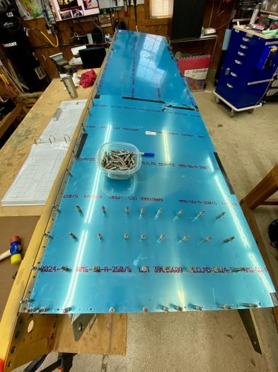

Clecoed the W-1027 A & B Inboard Doublers under the W-0002 Right Wing Inboard Top Skin. These are clecoed to the inboard ribs underneath.
Drilled #40 and #19 nutplate holes in the inboard top skin edge.
