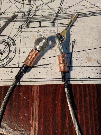

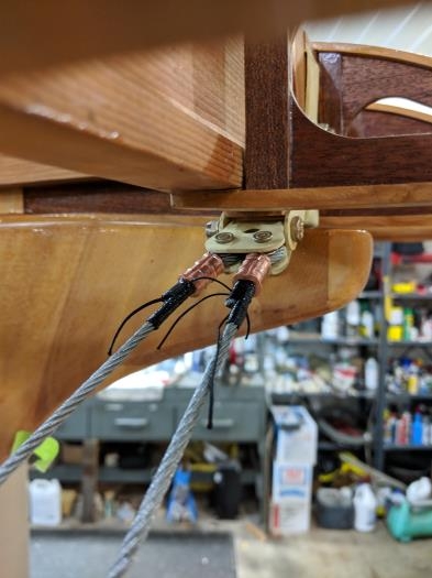

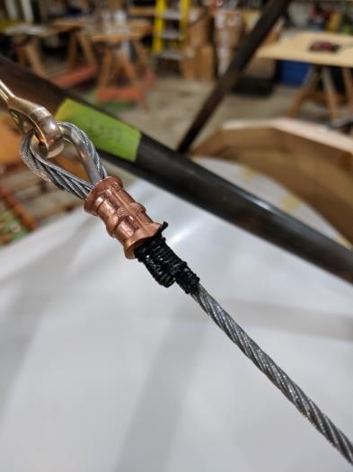

finished fabricating flying/landing cables
I single crimped all the landing/flying wires to length. I then triple crimped the cable clamps. Then the excess cable was cut off and the ends whipped with 30# mason line followed by a coat of brush on crazy glue.
both ends whipped
upper wing inboard attachment
upper wing outboard attachment
