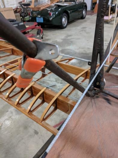

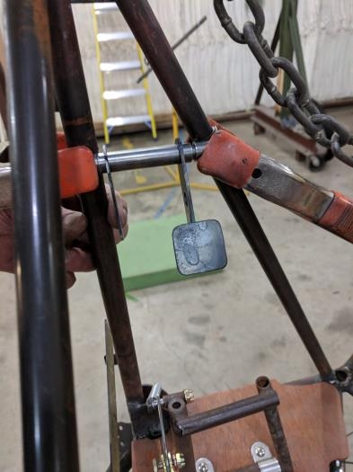

Re-did the toe brakes with the correct size tubing. Then fabricated the brake cable termination tabs to be welded on to the fuselage. They are threaded 1/4-28 for the cable adjusters.
redone toe brakes
outer cable termination tab
