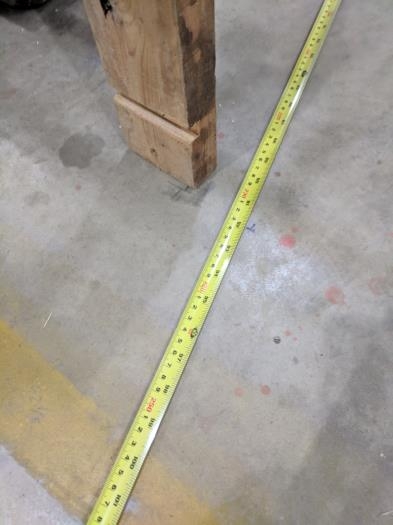

Brief Description:  Making sure fuselage is square
Levelled fuse and marked points on floor for measurement of squareness. Langing gear legs are square with the font of the fuse off center by a 1/4". The fuse and gear legs are off and slightly out of square. But not bad with out welding with it jigged. Front of fuselage level with axle. Should be good enough to weld axle upright sliders in place. Only the builder will know.
measuring points on floor
