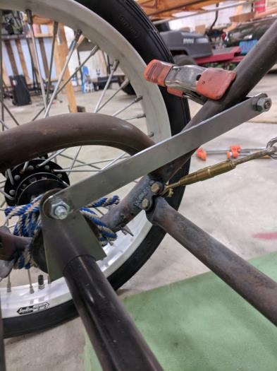

Brief Description:  axle anti-twist brackets
I ordered 5" drum brakes from Azusa today. Had them customized for my installation($14 extra charge). I have to fabricate a way to keep the axle from twisting when brakes are applied and this is my solution. I also spent a couple of hours installing new hardware. All hardware is now up to date.
left side
left side
right side
