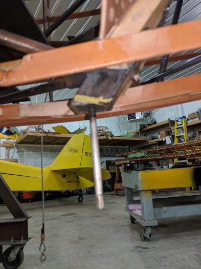

Modify floorbds and modify attach point

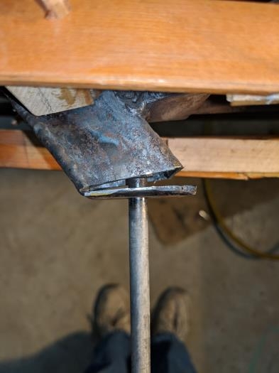

Cut rear attach point to match wing contour and raise up rtrailing edge of wing to get 1 1/2 degrees of incidence.

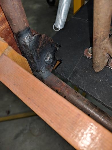

made room to capture bolt and nut
rear attach point before mod
rear attach point after mod
