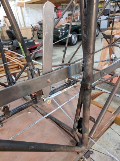

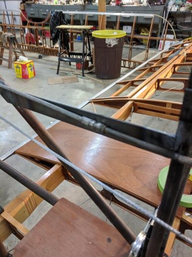

Today I fabricated the trim tab lever. Also welded the structure to fasten the trim tab to and forward section of the cable. I the cut a small piece of elevator out where the trim tab will be. I then made a braket to fasten the rear of the cable to and welded that bracket to the elevator. Established location for the fairleads to be mounted for the trim cable to pass through.
trim control
trim control
trim cable attachment
trim tab location on elevator
