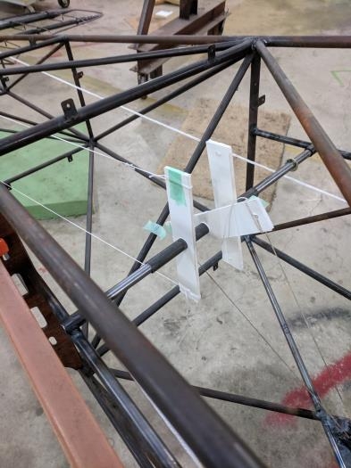

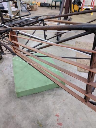

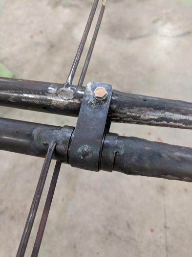

Welded washers on hinges for strengthening and rounded the corners. Ran strings from elevator transition through fuse to get locations of fairleads if needed. Close-up of transition with strings attached(pun intended).
finished hinges
route of elevator cables thru fuse
stick to elevator control transition
