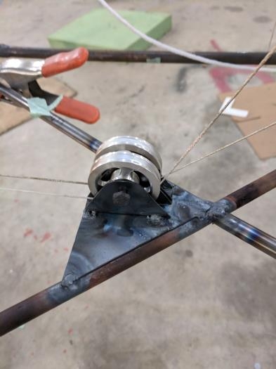

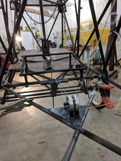

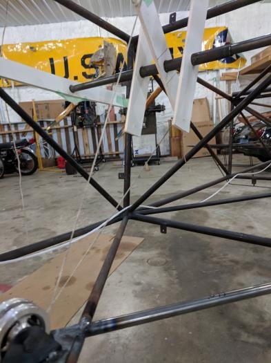

Fabricated cross diagonal to mount the pulleys on. Mounted pulleys to plate and tack-welded plate in place. Ran strings to simulate cable routing. Operation looks good. 4" of stick movement =
1 1/2" of elevator horn travel = 24 degrees of travel from neutral each direction.
view from the rear
view from the rear
cable direction transition pulley
mockup of the next step
