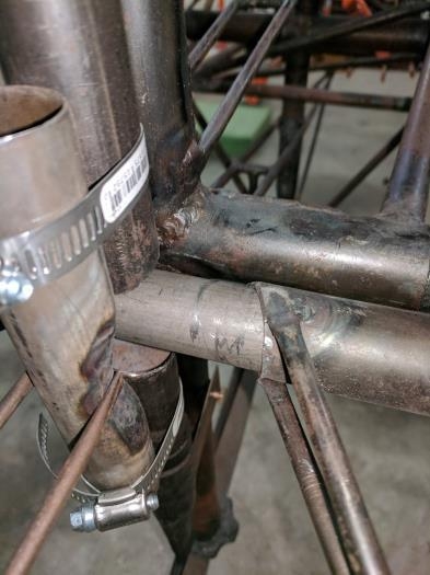

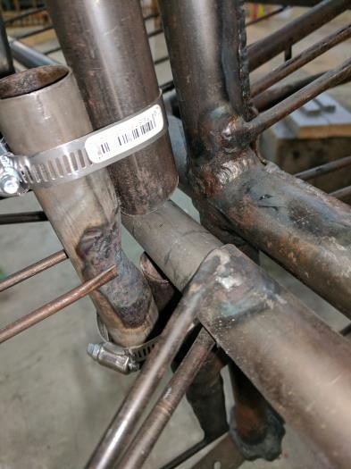

After discussion with mechanic, we decided to modify the rear control surfaces. removed the rudder and installed a carry through tube to join the elevators together into one piece. The rudder was then modified to bypass the carry through tube.
left view
right view
elevator carry through
