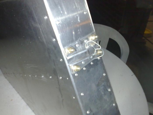

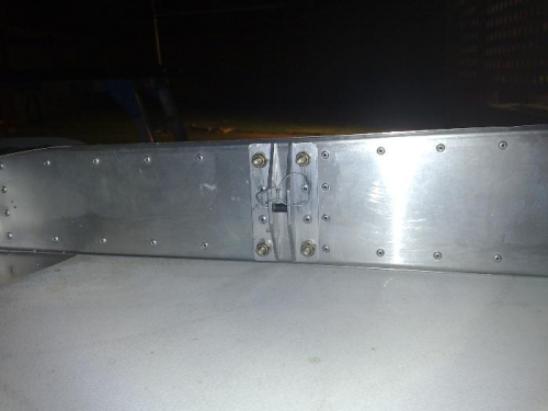

Top Bracket Modification
Modified the top rudder hing with the addition of two small bolts to the ouside of both brackets.
It has been noted that some rudders are coming loose with only the 4 riverts.
Bolted bracket with shim in place
