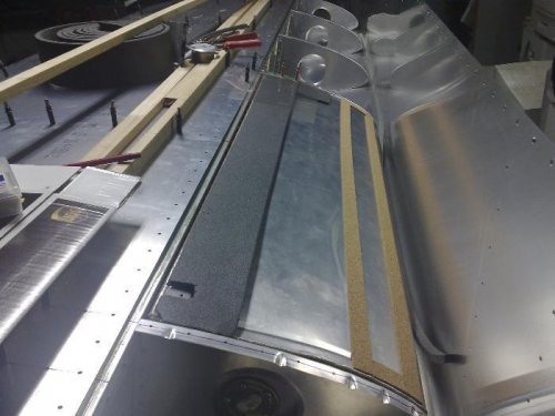

Brief Description:  Tanks in Place
Fitted the tank into place on the pilots wing. Added a strip of Able Flex (Concrete expansion joint rubber) to the back edge of the tank. I have sanded to shade to fit the profile of the tank. This helps arround the filler cap and helps take up the adjustment to the wing skin.
Cork and Able Flex Rubber

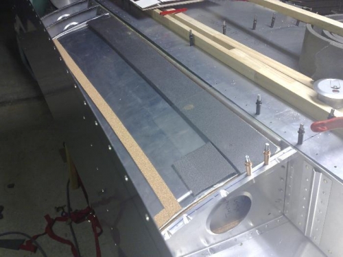

Filler tube to be cut through lower sqaure of
