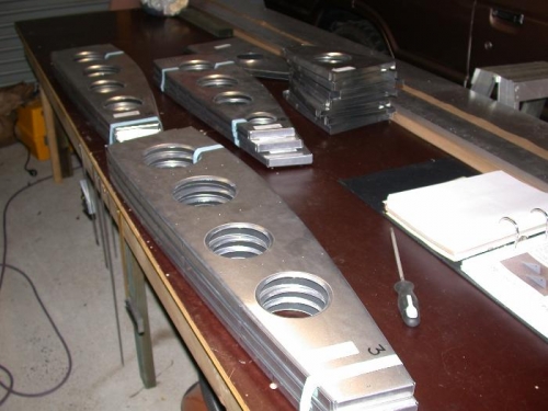

Started on the wings. Laid out all of the parts to check them.

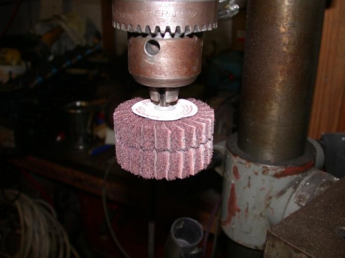

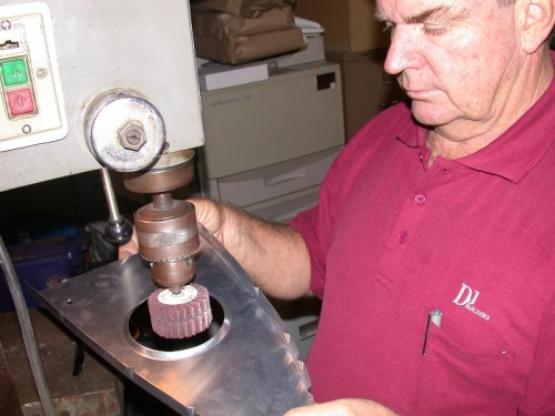

I used a flapper wheel in the drill press to smooth out any burrs that where on the parts (Lighting holes). Using this it was a very easy job.
Parts laid out
Flapper Wheel
Deburring the parts
