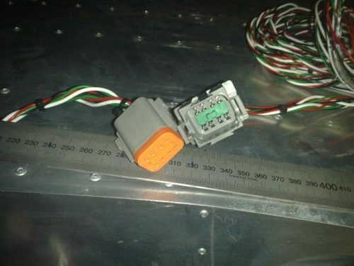

I have used Deutsch style plugs for all of the electrical connections. Th plugs are very easy to use and they are of a very high standard. (Computer quality). They are not the cheapest plug but they are water and dust proof and will not vibrate loose.
6 pin for the elevator trim
6 pin for the aileron trim

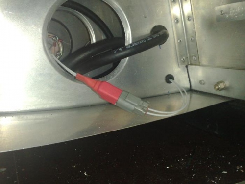

2 pin for the fuel gauge

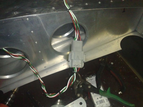

8 pin for the strobe lights and landing lights (using the LED lights system 4 wires each)
4 pin for the rear position strobe
Cost about $150.00 AUS for the lot
Fuel guage wires
Fuel guage wires
Strobe and landing light plug
Plug pulled apart
Plug pulled apart
