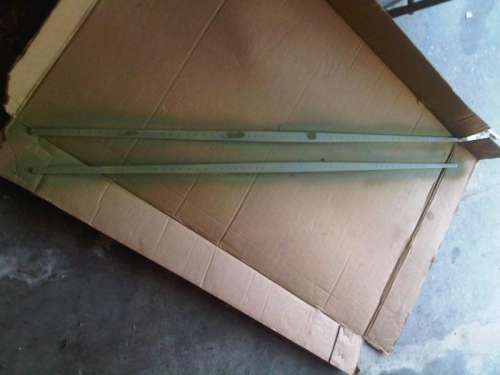

Spar strap constrction
Marking and drilling the Spar Strap.Drilled with a #40 drill bit on the drill press then primed with Green Zinc Chromate.
