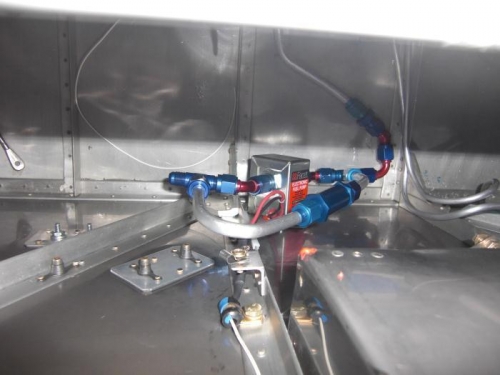

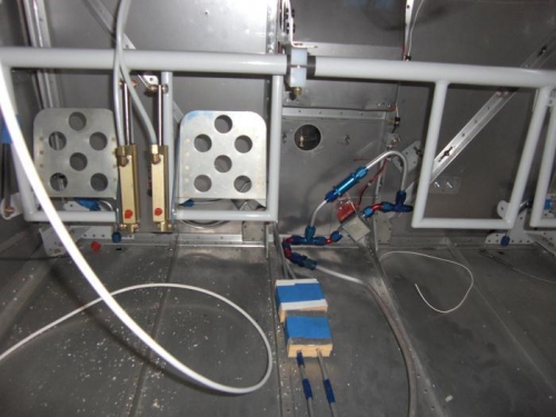

Brief Description:  Adding electrical fuel pump and bypass line
Designed my own bypass line as the drawings from Van's doesnt call this out. I think this is important as the fuel should not have to go through the electrical backup pump when it is not used. I cut the main line to the fuel pump, flared and added sleeve and nut and attached to the new bypass assembly. I also added a check valve for the bypass line. Torqued and aligned all parts.
