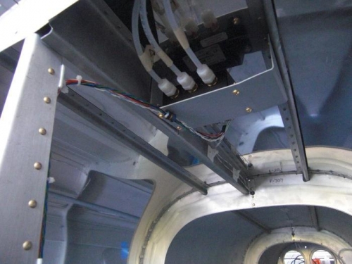

Brief Description:  Adahrs installed
I did the final installation of the Adahrs today. The bracket was installed with aluminum pop rivets and the unit was installed with brass screws and nuts. The harmess was hooked up and tied in and the OAT harness was plugged in and routed all the way back to the tail. The AOA, pitot and staic lines was permanently installed and tied in.
