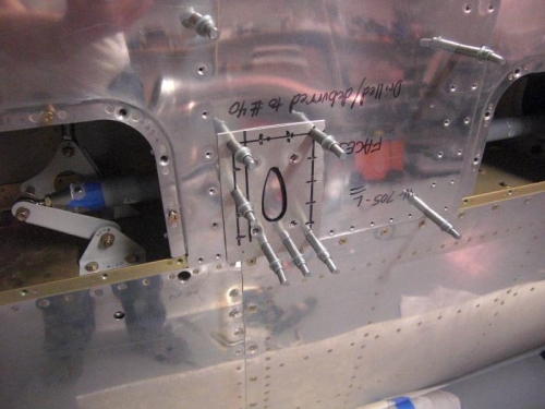

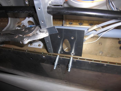

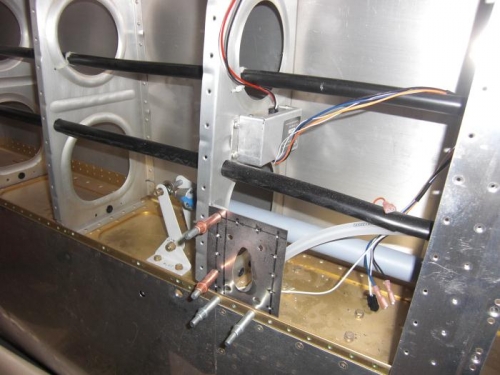

Brief Description:  Started making the pitot tube attachment
Making the necessary parts for the Dynon heated pitot/aoa tube. The attachment angle to the rib is in place and the base plate is drilled, deburred and dimpled. The wing skin is also drilled, deburred and dimpled. Now I need to figure out the attachment from the pitot aluminum tubes to the polyflow lines. The tube also needs to be removable, so the "service" lines needs to be long enough.
