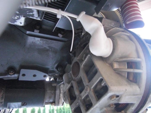

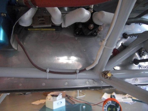

Cut the 10 gage wire and installed with terminal at the alternator end. Installed the fusible link at the amp shunt end. Connected the wires and zip tied around the engine and mount.
