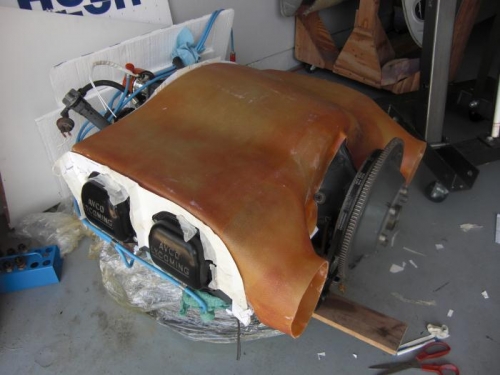

Brief Description:  James plenum and baffles

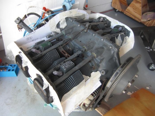

I received the plenum from Sam James and started working on the supporting baffles. He has hand drawn templates that he included, but the fit is not very good. I spent a few hours trying to get it to fit and to figure out how to modify it. Not an easy task...
I used card board for the templates. Once I get the engine installed I will cut the aluminum pieces.
